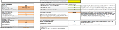

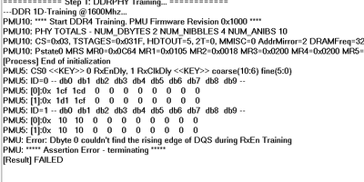

I encountered some problems when porting ddr4 4g. Attached is my configuration and error message. What should I do to solve this problem?
1,121 Views
joanxie
"PMU: Error: Dbyte 0 couldn't find the rising edge of DQS during RxEN Training".
>This error message implies that customer should check the conditions for DQS0 signals.
1,122 Views
joanxie
