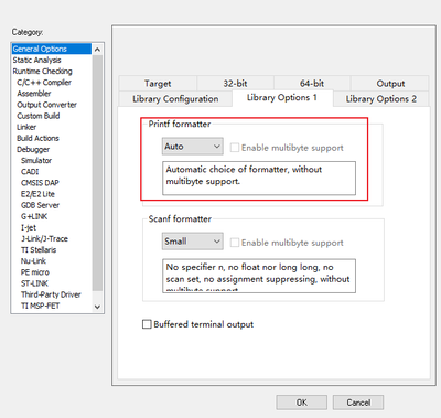

When developing I.MX9352 Cortex-M33 with IAR1 9.50.2, it was not possible to output floating-point data via redirected printf.
The SDK used is SDK_2_16_000_MIMX9352xxxxM
The following Settings have been made in the IAR Settings.
Here's my code:

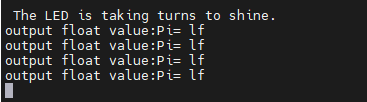

      PRINTF("output float value:Pi=%f %lf\r\n", Pi, Pi);
        SDK_DelayAtLeastUs(1000000U, SystemCoreClock);
        RGPIO_PortToggle(BOARD_LED_RGPIO, 1u << BOARD_LED_RGPIO_PIN);
The actual effect is as follows:

HL_G
Hi.@Zhiming_Liu
Thanks.
It seems that this approach is no better than using the sprintf function to convert to string output. Is there a way to print floating-point data directly using PRINTF?
Like this:
main()
double pi = 3.1415926;
PRINTF("pi = %f\r\n", pi);
The output:
pi = 3.141593

The existing PRINTF has a bit of a problem with float, or if you're not using serial printing and use printf inside the IAR
Zhiming
