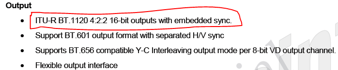

My vendor FAE said the output format is different bewteen OV5640 and TP2850, as below photo
And TP2850 support virtual channel ID, imx8mp doesn't support it
OV5640
TP2850
Please give me some suggestion

Hi @igorpadykov
    I found your article about imx8mp doesn't support MIPI-CSI virtual channels
    Do you have any idea about my question?
