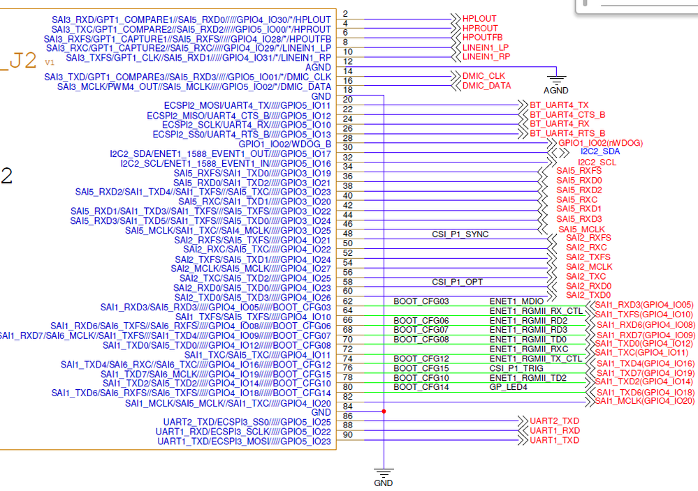

When we performed the operations in the attached document on the M4 processor of the IMX8MQ, we were unable to use the BT_UART4 pins (J2.20, 22, 24, 26) as ECSPI2. However, we were able to use and control the pins (J2.20, 22, 24, 26) as GPIO. Can you help us to enable ECSPI2 on the M4 processor? (Note: I using evk DART-MX8M.)
Below I share the sample code written in ecspi2. When used below code, ecspi2 could'nt work but the same pins I could use it as an GPIO pin. Do I need to changed dts files for using to ecspi2/ecspi3.

You should configure the RDC for use it under M core.
The configuration can be done on BL31:
https://github.com/nxp-imx/imx-atf/blob/lf_v2.6/plat/imx/imx8m/imx8mq/imx8mq_bl31_setup.c
