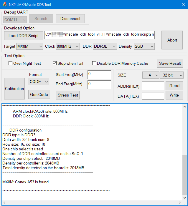

We use i.MX8M and DDR3L for our product.
The DDR3L(MT41K512M8DA-107 IT:P) is 8-bit width. That is, in order to take 32-bit width, we using 4 x DDR3L.
    - https://www.micron.com/-/media/client/global/documents/products/data-sheet/dram/ddr3/4gb_ddr3l.pdf
We performed the calibration using DDR tool and Aid Script which you posted.
   - i.MX8MSCALE DDR Tool Release
   - Aid Script which we edited is attached below.

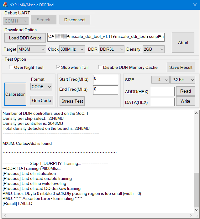

However, it Fail in DDRPHY training.
PMU: Error: Dbyte 0 nibble 0 rxClkDly passing region is too small (width = 0)
PMU: ***** Assertion Error - terminating *****
What does this mean?
Please tell me how to avoid this.

Hi george‌,
From the output message, the read DQ deskew training result in lower bits(3:0) of data byte[7:0] don't have enough margin, and training is failed.
PMU is referred to DDRPHY MCU.
dbyte0 is data[7:0]
nibbble0 is data[3:0]
B.R

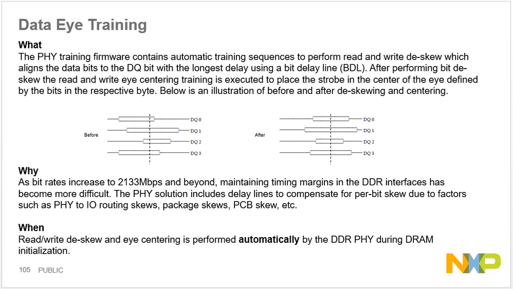

Does the read DQ deskew training which you say mean the Data Eye Training?
George
4,761件の閲覧回数
oliver_chen
Yes
