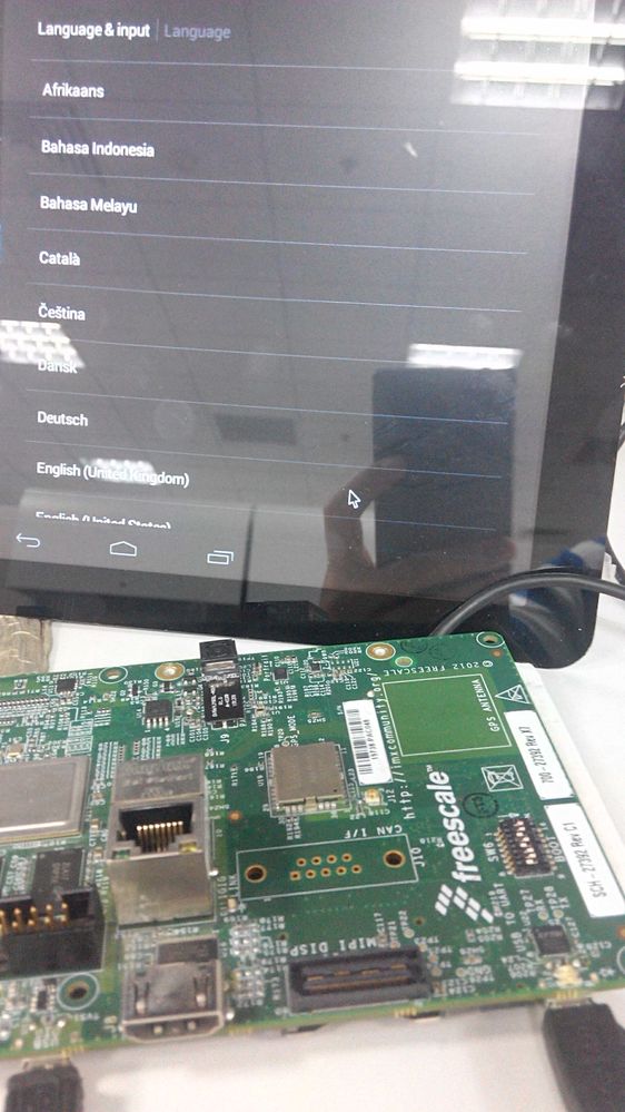

Hi All,
I want to know how to use Korean in Android.
Generally we can select the language from "Setting -> Language Support" of Android.
But I couldn't find that configuration in Freescale Android BSP.
Could you inform me how to use Korean in Android?
Our development environment is like as below,
- AP/Board : i.MX6DL-SabreSDP
- Android Version : Android 4.4.3 (Kernel 3.10.53)
Eric.

Hi Eric,
You can set the language in the "Setting -> Language Support" of Android. As you can see in the picture.
But about the Korean , it does not exist in the default BSP.
Hope this can help you.

erickang
Hi Dan,
Thanks for your response.
I confirmed Korean was not supported in Android KK 4.4.3.
I'll install an app to input korean keyboard.
Eric.
