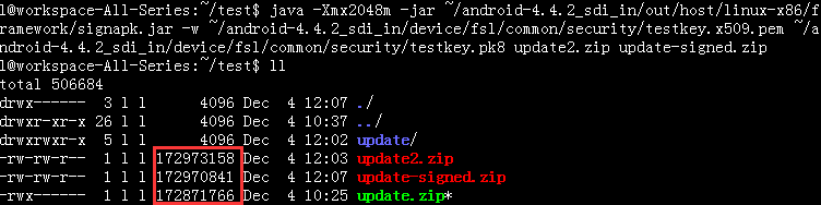

I generate update.zip by this command:
make dist -j4
and this update.zip can update my device system well in recovery.But when I unzip this update.zip then zip again without doing any modify,I found the file size changed and I can't do update,
My unzip and zip command is below:
unzip -d update update.zip
zip -r update2.zip update
Then I signed the update2.zip by the command below:
java -Xmx2048m -jar ~/android-4.4.2_sdi_in/out/host/linux-x86/framework/signapk.jar -w ~/android-4.4.2_sdi_in/device/fsl/common/security/testkey.x509.pem ~/android-4.4.2_sdi_in/device/fsl/common/security/testkey.pk8 update2.zip update-signed.zip
This update-signed.zip still not has the same size compare to update.zip,and still can't pass recovery to update system.
So my question is how to unzip&zip update.zip correctly?
Thank You

It looks like your zip command is wrong. Isn't creating an unwanted update/ folder at the root of the archive?
I think it should be:
cd update/ && zip -r ../update2.zip * && cd -
Gary

My update2.zip does't have the update folder.
Now I can use winRAR in Windows 7 to open update.zip directly and modify update.zip without doing the operations :unzip the update.zip to a folder and then zip again,and it works.
But I still want to do the normal unzip&zip way,where is my wrong?

Hi Quilong Li,
Ok, when I tried your command on my machine the update folder was in the update2.zip archive. I'm not sure what could be the difference then, in my case I use unzip/zip extensively with no problem. What is your zip version? Mine is 3.0, not sure if it helps.
