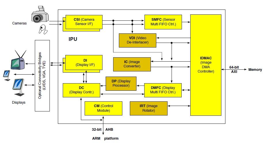

iMX6 camera patch to support CSI->VDI->IC->MEM and CSI->VDI->MEM capture
请问下面的路径代表什么含义?
1.) CSI->IC->MEM
2.) CSI->MEM
3.) CSI->VDI->IC->MEM
4.) CSI->VDI->MEM
另外,IC代指的是什么?谢谢!

qiang_li-mpu_se
That is the camera video data path, you can find it in reference manual, the IC module can do resize and CSC:

igorpadykov
Hi Steven
for understanding VDI may be useful presentation
A Deep Dive into Image Processing for i.MX 6 Series Applications Processors
