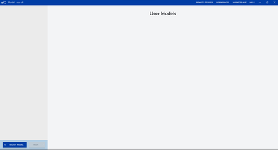

@Bio_TICFSL I'm interested in training custom models in the eIQ portal also. Unfortunately, the above hint doesn't make any sense to me.
I have the eIQ portal software installed and a data set imported.  I can train off the base models and validate on a remote target.
When I select the User Model button I get a blank screen. See attached screenshot. Is there a process for getting a custom model into the eIQ portal? I haven't found it in the documentation.
