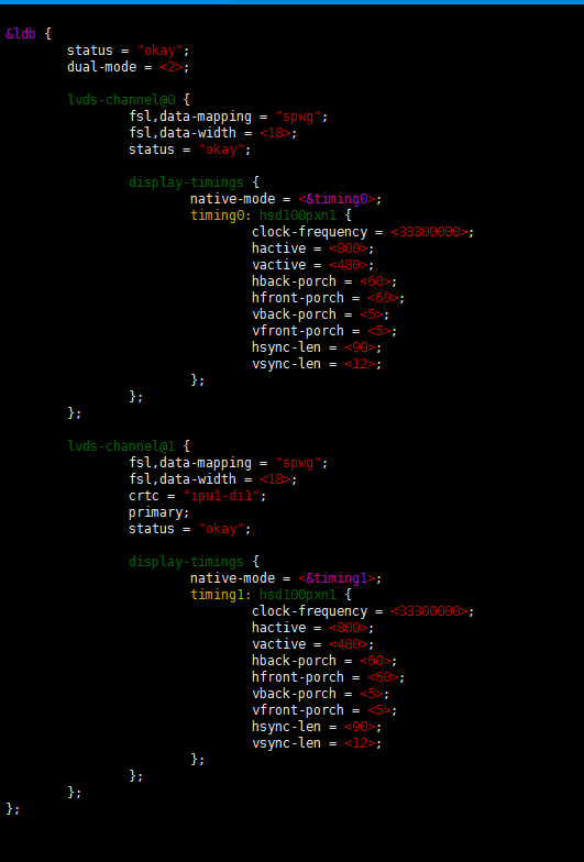

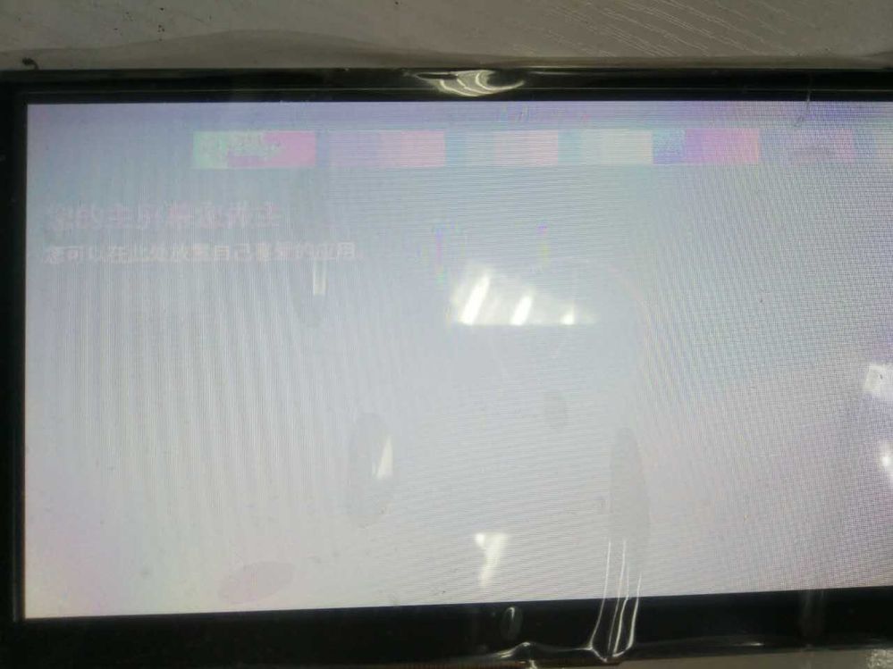

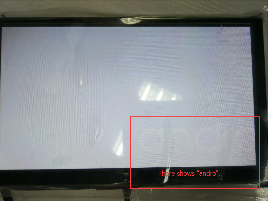

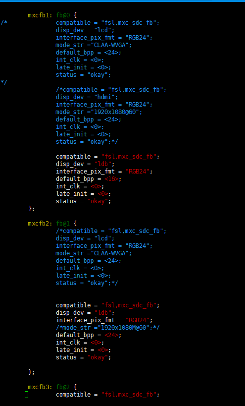

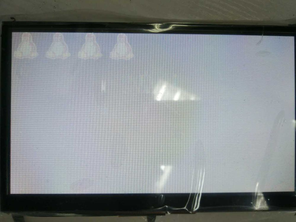

main chip :  IMX6Q
version : android 6.0
kernel : linux-4.1.15
Hello:
         I want to display through the lvds interface. However,I cannot find ldb_modedb[] in drivers/video/fbdev/mxc/ldb.c. What s more, no matter how I am modifying imx6qdl-sabresd.dtsi in kernel_imx/arch/arm/boot/dts/,
it didnt chang.Help, what can I do to make it normal.Looking forward to your response.
