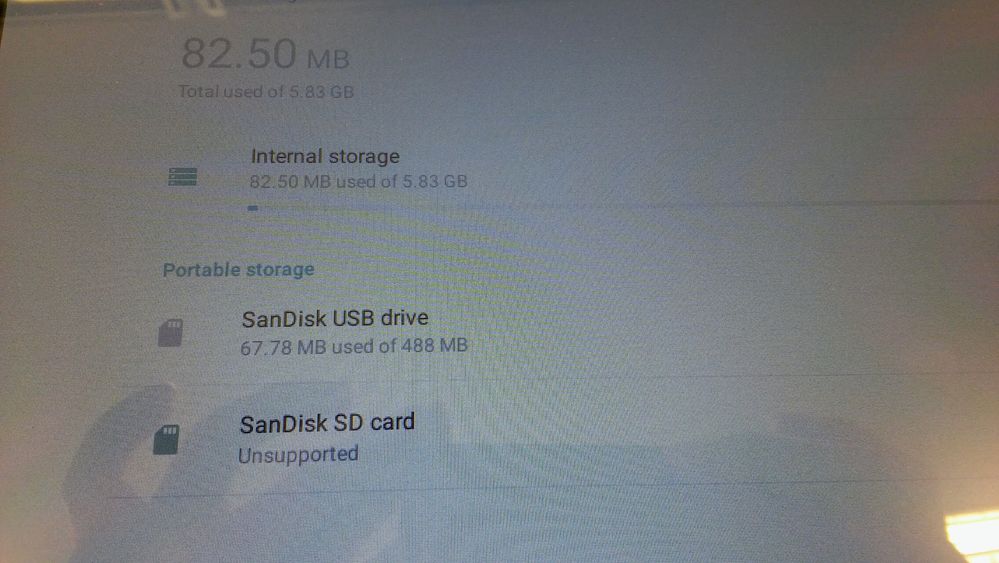

Hi NXP
Our platform is imx6q.  OS version is android 6.0.1.
Question 1   When we want to auto mount  the usb, where is the usb file nount path?
                     In android 5.1 or 5.0. auto mount the usb disk is success.
                     If we want to check the file in usb disk, we can find the /mnt/media_rw/udisk in android 5.0/5.1.
                     Follow the fstab_sd.freescale :
/devices/soc0/soc.0/2100000.aips-bus/2184000.usb/ci_hdrc.0  /mnt/media_rw/udisk vfat defaults voldmanaged=udisk:auto
                    But android 6.0.1 is different, we can not auto mount the disk and can not find the file.
Question 2  How to do modify the fstab_sd.freescale?
                   Step 1   We plug in usb disk.
                   Step 2    Then we check Settings --> Storage &USB  in Android 6.0.1, we can not find the usb .

nguyenmr
i've mounted successfully USB stick to both USB host and OTG on Kernel 4.1.15, android 6.0.1.
if you use usb host (0 or 1 or both ) you can use:
/devices/soc0/soc/2100000.aips-bus/2184000.usb/ci_hdrc.0*  //for host 0
/devices/soc0/soc/2100000.aips-bus/2184200.usb/ci_hdrc.1*  //for host 1
if you use usb OTG, no need to add anything.
BR/Nguyen

dennyzhou
  I have met this problem. And I just fix it now. The root cause is mentioned here.
[Android 6.0.1] How to setting or modify parameter for mount USB in host USB port?
https://community.nxp.com/thread/429690
 [Also raised by Huang]
  Jim.LIN, NXP's guy, gave the correct answer.
"The root cause if that if you need host1, you need change fstab.freescale to host1 then android vold can know this.
Change /devices/soc0/soc.0/2100000.aips-bus/2184000.usb/ci_hdrc.0* to
/devices/soc0/soc.0/2100000.aips-bus/2184200.usb/ci_hdrc.1*
  In our project, we use sabresd-imx6dq as base. Then we add an Usb-HUB in USB1. Firstly, we cound not use FIle Explore to access any U-disk. Now we changed the fstab. It has been fixed.
  The data'0x2184200' has been defined for USB1 in the 'imx6qdl.dtsi(?)' file of Kernel4.1.5. The original configuration of fstab may just used for OTG/USB0 on demo board, as USB1 are not used on sabresd-imx6dq board? We just need to update it according to our HW change in projects.
Thank you
BR//Bing.

CarlosCasillas
Hi Huang,
I have tested the Android 6.0.1 Demo image on an i.MX6Q SABRE-SD board, and it is auto-mounting the USB disks; their content could be visualized on the file explorer.
If what you want to access to the mounting path over the serial terminal (as you mentioned, on /mnt/media_rw), I tested on this way and I got permission error. The Demo images are not rooted, so, if you need root access on the serial terminal, it is required to build the image with the option “userdebug”, as indicated on section 3.4 “Building Android images” of the “Android User's Guide” document (attached).
Hope this will be useful for you.
Best regards!
/Carlos
3,257 Views
charleshuang
Senior Contributor II
Hi Carlos
I try again the Android 6.0.1 Demo image on an SABRE-SD demo board.  It's auto mount the usb disk.
The USB drive information will be show in  Andorid 6.0.1 (Setting/ Storage&USB/) .
Then, I try to test our platform.
It's can not show SanDisk USB drive information in Android 6.0.1 (Setting/ Storage&USB/).

I refer (2) log message.
Usb disk should be set the ci_hdrc.1
so I modify ci_hdrc.1 in fstab_sd.freescale ,but the result is the same.
/devices/soc0/soc.0/2100000.aips-bus/2184000.usb/ci_hdrc.1  /mnt/media_rw/udisk vfat defaults voldmanaged=udisk:auto
How can I do setting in Android 6.0.1?

CarlosCasillas
Hi Huang,
Have a look at "USB  media support" here. Traditional Storage | Android Open Source Project and here Adoptable Storage | Android Open Source Project
Some items have changed in MM and external storage seems to be a big one that affects many.
In Android 6.0, any device that is not adopted is considered portable. […] Third-party apps must go through the Storage Access Framework to interact with files on portable storage; direct access is explicitly blocked for privacy and security reasons.
