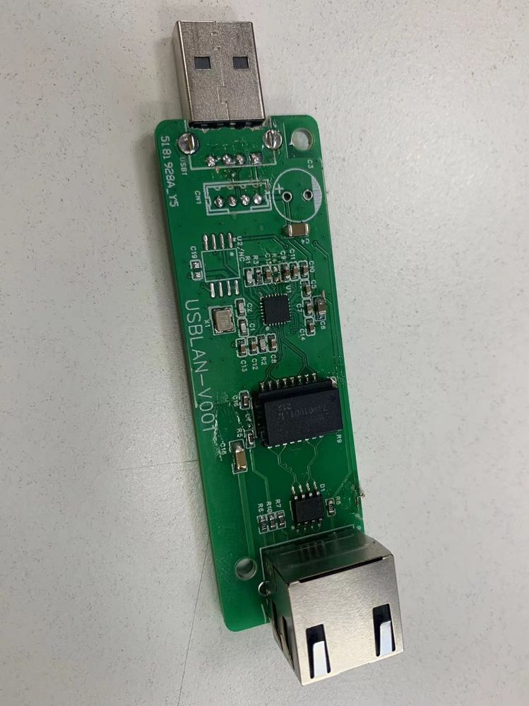

Dear all,
Now I have a project which need to support 2 ethernets. The first ethernet we can use the default one on iMX8mm, and the second one we are trying to use the USB-Ethernet, the chip is RealTek R8152B.
Now the driver works fine, and I can get the "eth1" device. But after I configed the IP address, and try to ping another IP, it failed. Ping report: Network is unreachable.
So anyone knows what happened? Am I missing any settings?
Best Regards~
Chad

chadA
Hi @Sanket_Parekh ,
Thanks.
But I do not undertand.
As you know, my device is a usb-ethernet, so it is connected to the USB port, for dts, the pin ctrl should configured into USB first. If the USB works fine, then there is no need to re-configured.
 I have a small board like this:
I connected it to the USB2.0 port on the board directly. So I think there is no need to configure the DTS.
Beside, same hardware connection, it works fine with Linux system.
Chad
