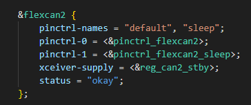

I noticed the flexcan2 is enabled by default in device tree
could you please verify it at runtime?

yes, can0 is the first enabled instance from Linux perspective.   It is CAN2 interface initialized from IMX93's perspective

danielchen
Hi @kual_gettobyte :
The device tree for imx93 frdm is located under folder
kernel-source/arch/arm64/boot/dts/freescale/imx93-11x11-drmd.dts.
status = "okay"  means this device is enabled by default

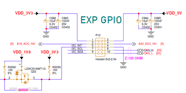

But just want to clarify couple of more things. This Flexcan2 is headed via P12 connector pins, viq its Pin 8 and 10 respectively? And this flexcan2 is with ARM Cortex A processor?
1,081 Views
danielchen
Yes, from schematics,  pin 8 and pin 10 are connected to CAN_H and Can_L, and Cortex-A can access CAN2 interface.

Just one more thing for clarification, this flexcan2 pins are mapped to P12 onboard connector..? CANH and CANL pins of this flexcan2 is headed via P12 Pin 8 and Pin 10 pins correct? And it is with coretx a core?
