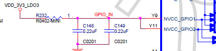

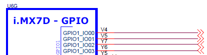

Hi All
The customer schematic as below:
How to set configuration GPIO_IO01 pull high 3.3V on the power up after, boot before uboot, thanks.

Hi Felix
out of reset state is described on Table 100. i.MX 7Dual 19 x 19 mm functional
contact assignments i.MX7D Datasheet
http://cache.nxp.com/files/32bit/doc/data_sheet/IMX7DCEC.pdf
and there is no way to change that behaviour immediately after power-up.
igor
