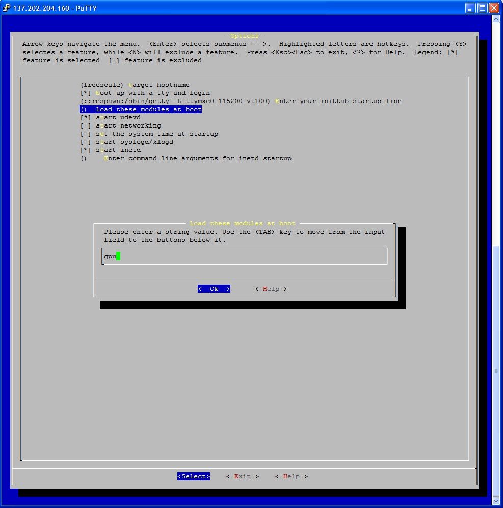

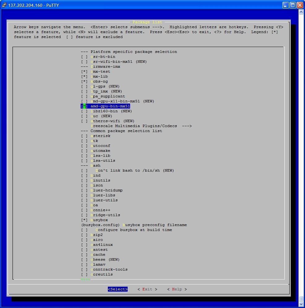

MuhammadAwaisAn
I think you missed to install and load the opengl lib.
You also need to load the GPU modules at startup:
best,
Awais

TxPomeroy
Just a couple questions?
What board are you using?  I've been able to get it working with i.MX53 QSB.
Did you rebuild inflexion_demo for your target board?
Have you downloaded the Freescale Multimedia Plugins/Codecs and included them in your kernel/rootfs build?
Did you rebuild kernel/rootfs with "freetype", "libpng", and "zlib"?
A good reference is chapter 3 of Mentor Graphics doc titled "Inflexion UI for Select i.MX Processors by Mentor Embedded" Software version 2.3, March 2011.  It details how to do all of this.
My first attempt at running inflexion_demo was with the Digi ConnectCore dev board. That has all kinds of problems when you try to run it and just copying libs over to the target as dependency errors are encounted won't get you to a working demo.  I'm told Digi is working on it but have no idea when or if they'll get it done.
One note: when you rebuild the inflexion_demo go ahead and use the no_gpu version.  If you're using the i.MX53 QSB you'll use the gles2 inflexion engine lib (copy to target at /usr/lib) but you should still build with the makefile pointing the .h file for the nogpu version.
Hope this helps.
