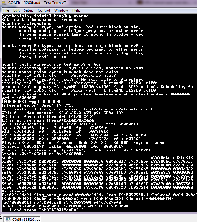

Senior Contributor I
EVK                                : MCIMX28EVK
Linux Kernel version     : 2.6.35
Mfgtools                         : Mfgtools-Rel-1.6.2.048
I configured the firmware build profile
./ltib -selectype
(imx28) --->
(mfg firmware profile) --->
Toolchain (ARM, gcc-4.4.4, multilib, neon optimized)
command line : noinitrd console=ttyAM0,115200 root=/dev/mmcblk0p3 rw rootwait ip=none ssp1
Then I build linux bsp by using ./ltib command.I have extracted the boot stream source file.
./ltib -p boot_stream.spec -m prep
  Applied the following patch
0001-ENGR00243127-MX28-mfg-updater.sb-can-not-run-success.patch
Then I built bootstream
./ltib -p boot_stream.spec -f
The generated files - updater.sb, updater_ivt.sb, imx28_ivt_linux.sb, imx28_ivt_uboot.sb, imx28_linux.sb, imx28_uboot.sb, uImage,rootfs.tar.bz2 are copied to specific folder of mfgtools.
But I am getting the following error.
Freeing init memory: 128K
starting pid 1768, tty '': '/etc/rc.d/rcS'
Mounting /proc and /sys
mount: wrong fs type, bad option, bad superblock on tmpfs,
       missing codepage or helper program, or other error
       In some cases useful info is found in syslog - try
       dmesg | tail  or so
mknod: /dev/console: File exists
mknod: /dev/null: File exists
Starting the hotplug events dispatcher udevd
udevd[1777]: init_udevd_socket: error getting socket: Address family not supported by protocol
error initializing udevd socket
udevd[1777]: main: error initializing udevd socket
Synthesizing initial hotplug events
Setting the hostname to freescale
Mounting filesystems
mount: wrong fs type, bad option, bad superblock on shm,
       dmesg | tail  or so
mount: wrong fs type, bad option, bad superblock on rwfs,
       dmesg | tail  or so
mount: sysfs already mounted or /sys busy
mount: according to mtab, /sys is already mounted on /sys
mount: mount point /proc/bus/usb does not exist
starting pid 1804, tty '': '/etc/rc.d/rc_gpu.S'
can't run '/etc/rc.d/rc_gpu.S': No such file or directory
starting pid 1805, tty '': '/sbin/getty -L ttyAM0 115200 vt100'
process '/sbin/getty -L ttyAM0 115200 vt100' (pid 1805) exited. Scheduling for restart.
starting pid 1806, tty '': '/sbin/getty -L ttyAM0 115200 vt100'
Unable to handle kernel NULL pointer dereference at virtual address 00000008
pgd = c0004000
[00000008] *pgd=00000000
Internal error: Oops: 17 [#1]
last sysfs file: /sys/devices/virtual/vtconsole/vtcon1/uevent
CPU: 0    Not tainted  (2.6.35.3-670-g914558e #3)
PC is at fsg_main_thread+0xb40/0x2424
LR is at fsg_main_thread+0xb40/0x2424
pc : [<c023ce8c>]    lr : [<c023ce8c>]    psr: 60000013
sp : c7c65ef8  ip : c7c65ef8  fp : c7c65fc4
r10: c7c64000  r9 : 00c03965  r8 : c0396514
r7 : 00000000  r6 : c034e490  r5 : c0396504  r4 : c7c98600
r3 : 00000000  r2 : 00000001  r1 : c7c65f7c  r0 : c0396514
Flags: nZCv  IRQs on  FIQs on  Mode SVC_32  ISA ARM  Segment kernel
Control: 0005317f  Table: 46fc8000  DAC: 00000017
Process file-storage-ga (pid: 164, stack limit = 0xc7c64270)
Stack: (0xc7c65ef8 to 0xc7c66000)
5ee0:                                                       c7c9865c c031e318
5f00: c7c259e0 00000026 00000000 000000c0 0000c039 c7c986ba c7c986bd c7c986bc
5f20: c7c986bb c7c65f88 00000000 00000000 c7c98604 00c03965 c7c986b0 c7c98640
5f40: c7c986b3 c7c986b4 c7c986b5 c7c986b2 c7c986b6 c7c986b9 000000c0 0000c039
5f60: c7c24000 c034475c c7c65f94 c7c986b8 c7c986b7 c7c9ec80 c033c318 00000000
5f80: c7c259e0 c0057a1c c7c65f88 c7c65f88 c02a141c c00405e4 00000000 c7c27ed0
5fa0: c7c65fcc c023c34c c7c98600 00000000 00000000 00000000 c7c65ff4 c7c65fc8
5fc0: c0057588 c023c35c 00000000 00000000 c7c65fd0 c7c65fd0 c7c27ed0 c0057504
5fe0: c0045c28 00000013 00000000 c7c65ff8 c0045c28 c0057514 00000000 00000000
Backtrace:
[<c023c34c>] (fsg_main_thread+0x0/0x2424) from [<c0057588>] (kthread+0x84/0x8c)
[<c0057504>] (kthread+0x0/0x8c) from [<c0045c28>] (do_exit+0x0/0x5f0)
r7:00000013 r6:c0045c28 r5:c0057504 r4:c7c27ed0
Code: e1530007 03a07000 e1a00008 eb019316 (e5d73008)
---[ end trace 7ab07b70219ce5af ]---
process '/sbin/getty -L ttyAM0 115200 vt100' (pid 1806) exited. Scheduling for restart.
starting pid 1807, tty '': '/sbin/getty -L ttyAM0 115200 vt100'
process '/sbin/getty -L ttyAM0 115200 vt100' (pid 1807) exited. Scheduling for restart.
starting pid 1808, tty '': '/sbin/getty -L ttyAM0 115200 vt100'
process '/sbin/getty -L ttyAM0 115200 vt100' (pid 1808) exited. Scheduling for restart.
How to solve this?

igorpadykov
Hi Pt
you can try kernel command line: -e console=ttyAM0,115200 rdinit=/linuxrc rw gpmi
igor

pt
I have change the command line to console=ttyAM0,115200 rdinit=/linuxrc rw gpmi
It fails at 'partitioning SD card' Stage

Starting UTP
ln: /etc/mtab: File exists
disable turn off display
uuc 0.4 [built Oct 17 2014 12:16:14]
UTP: Waiting for device to appear

UTP: received command '$ sdimage -f $FILE -d /dev/mmcblk0'
UTP: sending Busy
UTP: executing "sdimage -f $FILE -d /dev/mmcblk0"
Can't found boot stream partition
UTP: sending Non-success
utp_poll: exit with status 65280
3,077 Views
igorpadykov
what is device you are trying to write to ?
In general you can try other new card from well known vendors.
3,077 Views
pt
I am using SD card.
3,077 Views
igorpadykov
just for test recommend to check with ordinary (<2GB) SD card.
