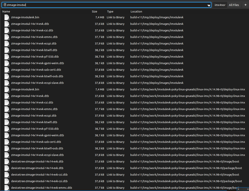

toanjunifer
Senior Contributor I
Hi YuriMuhin_ng‌,
Thank you for your reponse. I going to try follow your guide. May I ask you one more question ?
What is the kernel file for iMX6UL-EVK with boot from QSPI ?
This is list of kernel which I search in build directory.
Thank you so much,
Toan
4,836 Views
Yuri
   kernel and DTBs are described in Table, named  "Kernel and device tree configurations" of
i.MX_Linux_Release_Notes.pdf.
Yuri.
