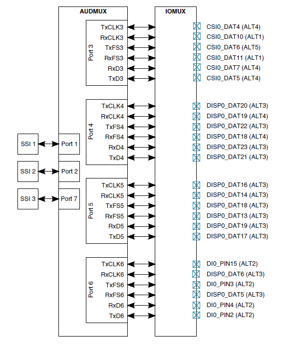

I want to create a custom board based on i.MX6 which needs to use the three ssi ports connected to the audmux which is connecing to 3 audio sources via 3 external ports. My doubtful areas are:
1. How to configure the three ssi??
        Do we need to make 3 structure of struct mxc_audio_platform_data instances for the three ssi in the board info file like
        static struct mxc_audio_platform_data mx6_audio1_data = {
            .ssi_num= 3, (is this the total number of ssi used or the ssi port used)
            .src_port = 5, // Port5: AUD5
            .ext_port = 2, // Port2: ssi-2
            .hp_gpio = -1,
     (do we need 3 structures like this???)
2. How to configure the audmux
3. I want to connect 2 i2s audio input( obtained from another board as audio samples) and one sgtl5000 codec. can i use imx6 as slave for the 2 i2s input and master for sgtl5000 codec?. If yes how is the configuration done?

Hello,Sebi,
      Let me explain this structure at first .
(1)Explanation of data structure
#define SABRESD_HEADPHONE_DET IMX_GPIO_NR(7, 8)
            .ssi_num= 1,// (Which SSI will be used, SSI0,SSI1 or SSI2, here means we will use SSI1 )
            .src_port = 2, // Internal connection is SSI1 to Port 2 of AUDMUX
            .ext_port = 5, // External port of AUDMUX is No.5(AUD5). For i.mx6 cpu, AUD3,AUD4,AUD5 and AUD6 can be muxed to PADs to connect with external deivce)
            .hp_gpio = SABRESD_HEADPHONE_DET,//here is a gpio used to detect if Headphone is input.
The following is diagram for SSIx and AUDMUX, you can see in reference manual:
SSI1/SSI2/SSI3 in diagram are SSI0/SSI1/SSI2 in BSP.
(2)Using 3 SSIs of I.MX6
In addition, From reference manual of I.MX6DQ, SDMA can access SSI0,SSI1 and SSI2 module, So they can be used to transimit High-bandwidth data. But on our evaluation board, we don't use 3 SSIs to connect 3 different devices. So we don't have corresponding experience to share with you. and not recommend you use 3 I2S of I.MX6 simultaneously.

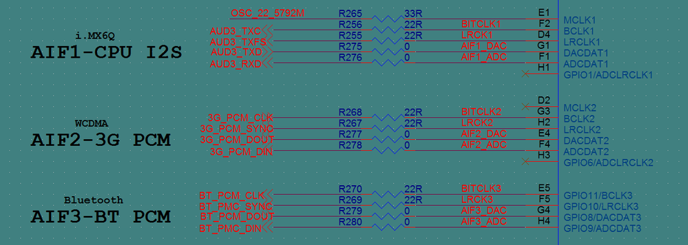

(3) The following solution is recomended to you.(Using a audio code with 3 I2S Interfaces, such as WM8958)
Driver of WM895 has been supported in linux BSP, this can help you to save development time. The following is an example schematic. MCLK can be 24MHz that output from GPIO_0 on CPU.
I think maybe wm8958 can be suitable for your requirement.
