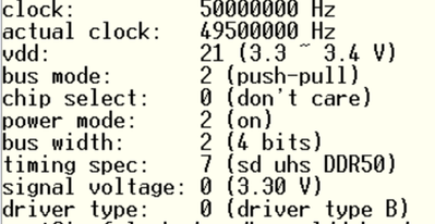

Dear Joanxie,
Thank for your information.
I have a question about the uSDHC1.  Is the uSDHC1 the same Micro-SD(SD2)(ref:below picture).
Sorry for the confusion, I said mmc1 means to Micro-SD.
B.R.
Bill
4,259 次查看
joanxie
pls see his :
SDHC2 is for MicroSD , SDHC1 is for IWFI/BT
4,252 次查看
billwu
Dear Joanxie
If I want to use SDIO interface of SDHC2, could I reference "https://community.nxp.com/t5/i-MX-Processors-Knowledge-Base/Enabling-uSDHC1-of-i-MX8MM-Based-On-L5-4..."?
B.R.
Bill
4,243 次查看
joanxie
yes, this document is for uSDHC1, if you need to use uSDHC2, you can refer to the document and change the dts according to your own design
