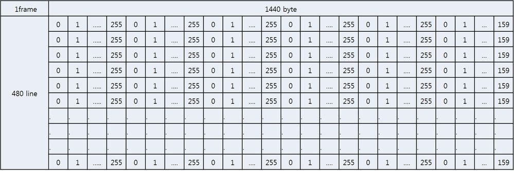

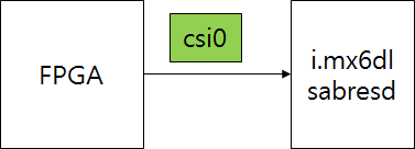

Test the data transfer use csi0 port.
I send data to i.mx6 board .
we want to  data transform is below fig.
use BT656
result data file.
use test program : mxc_v4l2_capture.c (device driver) file and mxc_v4l2.capture.c(app) .
size 1024 * 768
i want to get data like that 0 1 2 3 4 5 .... 255 .... but result of test is not good.
when i get data ,result is 0 0 0 1 1 1 2 2 3  3 4 4 ... 255  ..
Why am i get wrong data...?  please reply your opinion..
wrong data file is attach this page.

Hi Hanseung
for BT656 format mxc_v4l2_tvin should be used
igor
