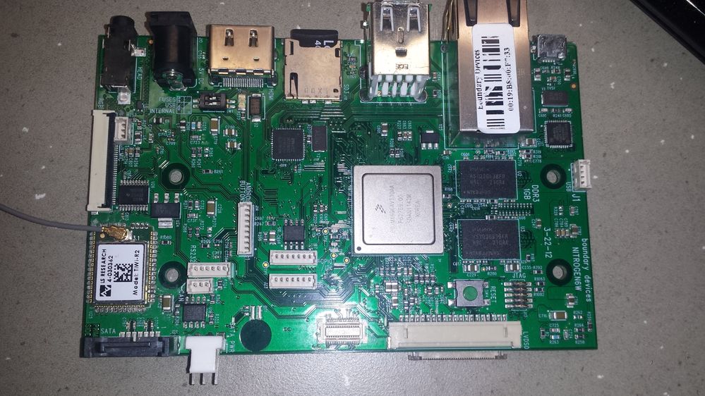

I inherited a couple Nitrogen 6W boards from my work. They have a 3-22-12 release date and u-boot "U-Boot 2009.08 (Jul 05 2012 - 15:37:27)" I am trying to get the stock Android distro on them.
this is what I get with Android 601:

This is what I get with 711:

gary_bisson
Senior Contributor III
Hi Sean,
Please visit our wiki:
Wiki - Boundary Devices
You'll find:
- How to update your U-Boot to latest 2017.07 (yours is too old)
- How to download and flash latest stable Android (Nougat, yours is too old)
Gary
3,260 Views
seanwalton
Thank you for your reply. I have been trying to update the uboot (I bricked the device) without success. Perhaps you can help. Here is a photo of the board so that you can see version, etc.
I start up sb_loader.exe:
1) u-boot.nitrogen6sx, *6s, and *max install but cannot start up
2) u-boot.nitrogen6q loads and starts
3) *6q expects 6q_upgrade, but only 6x_upgrade is available and according to the website, 6x_upgrade replaces 6q*
4) resorted to stripping 6x_upgrade down to a few crucial, relevant steps:
erase_size=0xC0000
offset=0x400
a_base=0x10008000
setexpr a_qspi1 ${a_base}
setexpr a_qspi2 ${a_qspi1} + 0x400000
setexpr a_uImage1 ${a_qspi1} + 0x400
setexpr a_uImage2 ${a_qspi2} + 0x400
setexpr a_script ${a_base}
sf probe || sf probe || sf probe 1 27000000 || sf probe 1 27000000
fatload mmc 0:1 ${a_uImage1} u-boot.nitrogen6q
sf erase 0 ${erase_size}
sf write ${a_uImage1} 0 ${filesize} #---Line #6
5) Base memory address (0x12000000 or 0x82000000) failed, so I used the address we use on a custom i.mx6 board: 0x10008000 -- It worked and grabbed the uboot image successfully.
6) I tried with and without ${offset}. Ultimately, I stuck with the base address, because 0x400 appeared to be protecting something, and since my board was bricked, I figured that it couldn't hurt.
7) I tried to burn *6q, but it would not boot; I tried *6SX. It seemed to me that *6q should have worked, because I had USB-booted with the exact same image.
What should I try next?
-Sean
3,260 Views
gary_bisson
Hi Sean,
Please read the wiki, it does provide the "manual procedure" to update U-Boot without using 6x_upgrade for very old U-Boot.
Also, the Nitrogen6w needs u-boot.nitrogen6q, do not try any other configuration.
Gary
3,260 Views
joanxie
how did you program them to the board? by mfgtool? did you  use demo image or customized image? I don't have this board to test for you, so pls share with me more detailed information.
3,260 Views
seanwalton
I downloaded and used the image under "for the impatient." I could not find a way to create a custom image.
From Linux, I burned the bootable image on a micro-sd and tried to boot from it. UBoot complained that it did not recognize the partition table. So, I assumed that the UBoot version was too old (2009/08) and tried to update UBoot.
At this juncture, I bricked one of the two boards while trying to update UBoot. I will try to get you more info...
