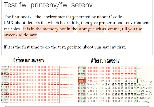

From the tutorial in attachment, it is said :
I would like to know if there's any way to have default u-Boot's environment variables in the storage without using the saveenv command once as we plan to remove the serial debug interface and serial download interface (i.e. without u-Boot access) from an iMX8M Plus based system with SD card as only storage, please ?

It is no difference between under arm linux with real device sdcard/emmc and x86/x64 linux with sdcard mirror(or real sdcard).
The document is just under arm linux with real device sdcard/emmc.
Now You just need to compile a x86/64 fw_setenv/fw_printenv.
Others are the exactly the same.
you can use "make u-boot-initial-env" to get the default  uboot env. (So far, the yocto use the same way output the env in its deploy)

If you need a binary env, you can use mkenvimage to convert it.

fw_env.config
#a.sdcard 0x400000 0x4000 #8MQ,8MM, 8MN, 8MP since lf-5.10.52-2.1.0
#a.sdcard 0x400000 0x2000 #8, 8X,8ULP
a.sdcard 0x400000 0x1000 #8MQ,8MM, 8MN, 8MP
and
fw_setenv  has  "-f" for the first time, the device has no env yet. The env file is the previous command  "make u-boot-initial-env", you got.
You can use the -f  or you can prepare a scard/emmc mirror has env inside(use x86/x64 fw_setenv set it or use  mkenvimage get binary env to integrate it).
