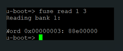

kirankumar007
I.MX8MP EVK JTAG Detection issue.
Default image eMMC booted stopped at Uboot using putty.
After uboot Read following data received in Putty Terminal,
0x470[21]  SJC_DISABLE  is =  0x1
0x470[23:22]  JTAG_SMODE[1:0][1:0] = 0x11
In data sheet
JTAG_SMODE[1:0] = 0x11 means [11 - No debug mode]
From these how to get back in to Debug JTAG mode????
Please guide us
