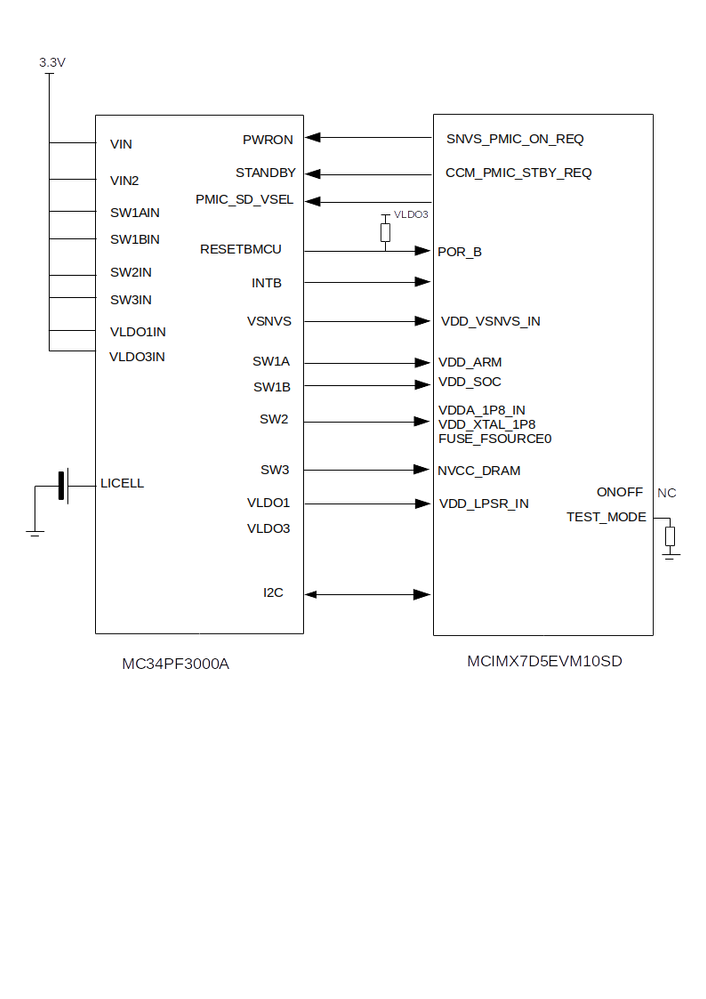

p_lenkow
Hi!
I cannot share all details but I made some block schematic which should cover all interesting things. I hope that now we can go forward and you may help me to understand to logic behind  SNVS_PMIC_ON_REQ.pmic_imx7d.png

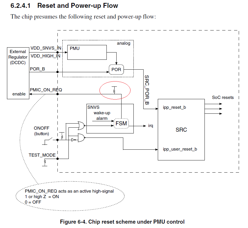

weidong_sun
Hello Pawel,
    See diagram from reference maunal, please!
There is an internal pull-up On the pin. So even if you don't have external pull-up resistor, the pin can also normally work.
Hope the information is helpful for you.
Have a nice day!
B.R,
Weidong
