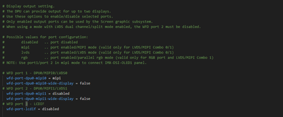

    I have config the graphics.conf again, the new modified show below:
# WFD port 1 - DPU0/MIPI0/LVDS0
  wfd-port-dpu0-mipi0 = mipi
  wfd-port-dpu0-mipi0-wide-display = false
# WFD port 2 - DPU0/MIPI1/LVDS1
  wfd-port-dpu0-mipi1 = mipi
  wfd-port-dpu0-mipi1-wide-display = false
# WFD port 3 - LCDIF
  wfd-port-lcdif = disabled

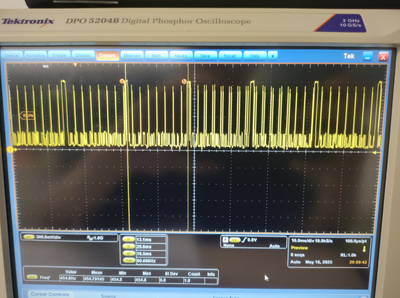

    And I remeasure the waveform of the CLK and DATA gpio of the serializer MAX96789, show as below:
(1) The CLK pin waveform:
As you can see, the frequency is 276MHz, meet my expected value.
(2) Data of High-frequency pin:
It is only 44KHz, the frequency is far below our expected value. Theoretically, the frequency of the MIPI-DSI high-frequency output pin should be consistent with the CLK frequency, so it should also be over 276 megahertz.

I was wrong on previous post. To enable MIPI-DSI, you need to do the following changes in graphics.conf:
begin wfd device 1
# Choose ONE wfd-dlls line that matches your hardware.
# iMX8QXP CPU board - HDMI display using IT6263 converter chips
# wfd-dlls = libwfdcfg-imx8qxp-hdmi-it6263.so libWFDimx8dpu.s
# iMX8QXP CPU board - HDMI display using IT6263 converter chips and parallel RGB display
# wfd-dlls = libwfdcfg-imx8qxp-it6263-parallel-LCD.so libWFDimx8dpu.so
# iMX8QXP CPU board - HDMI display using ADV7535 MIPI-2-HDMI converter board
wfd-dlls = libwfdcfg-imx8qxp-adv7535.so libWFDimx8dpu.so
# iMX8QXP CPU board - IMX-DSI-OLED1 panel with mipi-dsi interface and RM67191 driver
# wfd-dlls = libwfdcfg-imx8qxp-dsi-oled.so libWFDimx8dpu.so
As convertor ADV7535 is connected to MPI-DSI output. Then, the binary can be found in QNX SDP here:
../qnx700/target/qnx7/aarch64le/usr/lib/graphics/iMX8.../libwfdcfg-imx8qxp-adv7535.so
Can you please check to use this enable?

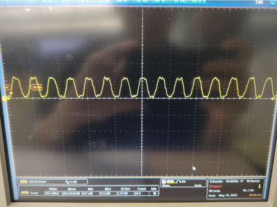

    I did the changes you suggested, I found the libwfdcfg-imx8qxp-adv7535.so in QNX SDP, then I build this binary into the image and load it into the board.
    After completing the preliminary preparation work, I re-measured the data and clock pins and found that the clock frequency was slightly higher than when libwfdcfg-imx8qxp-adv7535.so was not used before (previously 275MHz, now 297MHz), as shown in the following figure:
(1) Clock-Frequency Figure:

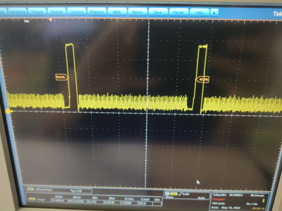

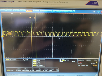

The frequency measured by the data pin is 25MHz for high speed and 45KHz for low speed, as shown in the following figure:
(2) High-Speed-Frequency Figure:
(3) Low-Speed-Frequency Figure:
(4) (High & Low)Mixed-Frequency Figure:
Due to unclear theoretical waveform and frequency of MIPI-DSI, I am not sure whether my current implementation is correct or not. Could you please check the wareform above ? Is it wareform of MIPI-DSI signal ?

Bio_TICFSL
your measured 25MHz seems it is too low. It would mean 4.16 pixel clock, which is not standard resolution (is it 640x480?).
To tell how should look correct frequency, could you please share what resolution are you setting?
In your case, it might help to define parameter the following parameters in file
imx8x-adv7535.c:
static const struct wfdcfg_keyval video_extensions[] = {
    { .key = TIMING_DSI_HBLANKING_MODE, .i = TIMING_DSI_HBLANKING_MODE_AUTO_BYTES, },
    { .key = NULL },
Do you have access to the mentioned file and could you compile it?
I have attached pictures from developers for your reference to see how the defines change the behavior. The third image (BTA) shows communication in low speed mode.
