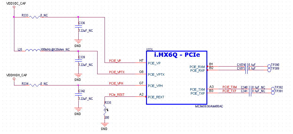

How to do with PCIE_REXT and HDMI_REF when not use PCIE HDMI on imx6solo?
1,713 Views
翔李
HI,
Can the R of PCIE_REXT and HDMI_REF be not stuff?
PCIE_RX to be gnd by C?

"The recommended connections for unused analog interfaces can be found in the section, “Unused analog
interfaces,” of the Hardware Development Guide for i.MX 6Quad, 6Dual, 6DualLite, 6Solo Families of
Applications Processors (IMX6DQ6SDLHDG)."
http://cache.nxp.com/assets/documents/data/en/user-guides/IMX6DQ6SDLHDG.pdf
