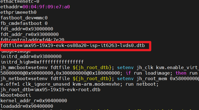

Rita_Wang
Hi @kazuhito_morita ,
Dtb file I use this one: fdtfile=imx95-19x19-evk-os08a20-isp-it6263-lvds0.dtb
For the
  • The console output of the media-ctl -p command executed on your board
  • The console output of the zcat /proc/config.gz command executed on your board
You need I add them to the attachment.
By the way,  if still not work in your side. You can use the support way I share you last time.
We do not have your board in hand, so can not debug it for, I confirmed in our side, for the in iMX95 Verdin board support you can contact the Toradex

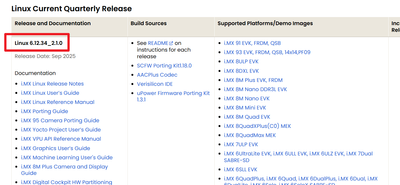

Rita_Wang
I am using the newest version BSP in our website:
For the others
I will test on our board later and then give you reply, so sorry for late test on it, too many task in hand.
769件の閲覧回数
kazuhito_morita
Hi @Rita_Wang
Thank you for your reply despite being busy.
The BSP version is the same as my environment.
I’m also using 6.12.34_2.1.0 now. However, the issue has not been resolved yet.
I’m looking forward to receiving the other two pieces of information.
