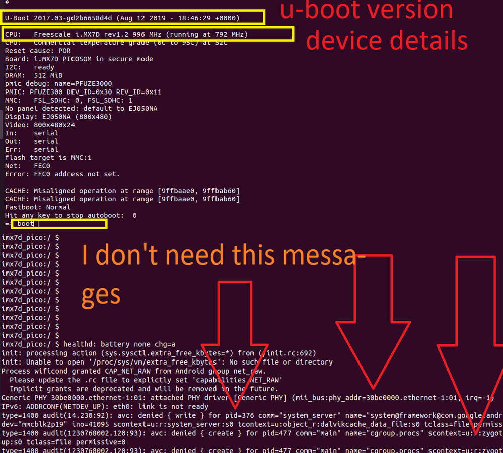

I have imx7d-pico running android things (kernel 4.9)
I accessed it through the command: sudo picocom -b 115200 /dev/ttyUSB0
However, as you can see in the images below, unwanted messages are leaving less than 1 second apart.
How to solve this(pls)

Then please try "dmesg -n 1"

b36401
Please try this message to decrease notifications:
# dmesg -n err
It means that only errors, not warnings and notices will be printed.
Then if it helps you can add this command to startup script.

|imx7d_pico:/ $ dmesg -n err
dmesg: not integer: err
Not solved yet

b36401
