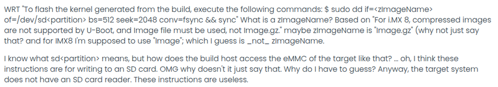

WRT "To flash the kernel generated from the build, execute the following commands: $ sudo dd if=<zImageName> of=/dev/sd<partition> bs=512 seek=2048 conv=fsync && sync" What is a zImageName? Based on "For i.MX 8, compressed images are not supported by U-Boot, and Image file must be used, not Image.gz." maybe zImageName is "Image.gz" (why not just say that? and for IMX8 I'm supposed to use "Image"; which I guess is _not_ zImageName.
I know what sd<partition> means, but how does the build host access the eMMC of the target like that? ... oh, I think these instructions are for writing to an SD card. OMG why doesn't it just say that. Why do I have to guess? Anyway, the target system does not have an SD card reader. These instructions are useless.

6. zImage vs Image vs Image.gz?
zImage: Compressed kernel. Don't use on i.MX8.
Image: Uncompressed kernel. This is what U-Boot on i.MX8 expects.
Image.gz: Gzipped kernel.
For i.MX8 use Image.
And yes, that kind of command if for SD cards. But again, you can avoid it using UUU tool.
