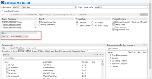

Hi team!
I started using MIMXR1170-EVK.
And I want to know how to create multi core project with MCUXpresso IDE from scratch,
not from sample project.
Is there any application notes or videos to refer?

Omar_Anguiano
Hello
Hope you are well.
This application note can be helpful: https://www.nxp.com/docs/en/application-note/AN13264.pdf
I see more feasible starting from an existing multicore example and integrate your application in that example.
For creating your example you might want to use the SDK wizard.
First, select the core for the project and assign it a role:
If the core is slave you can finish your configuration. If the assigned role is master then go to the Multicore slave projects in the next tab and link a slave project:
Let me know if this is helpful, if you have more questions do not hesitate to ask me.
