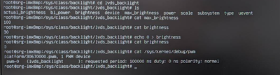

The LVDS panel can display normally. I want to control pwm backlight .
GPIO1_IO11 : pwm backlight
Please refer to my imx8mp-evk.dts :
lvds_backlight: lvds_backlight {
compatible = "pwm-backlight";
pwms = <&pwm2 0 100000 0>;
status = "okay";

cat max_brightness : This value is 100
cat brightness : This value is 80
echo 0 > brightness
cat brightness : This value is 0 but the LVDS panel can still display normally.
I use an oscilloscope to measure the PWM voltage . It always keep 3.3 V .
I add some log in pwm_bl.c .Please refer the pwm_backlight.log and pwm_bl.c .
Please help to solve this problem .

From the hardware desgin you attached, the PWM will be pull up with the VDDEXT_3V3, so this is normal. You can remove R2389 to get low value when brightness =0.
