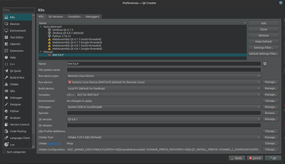

When I configure the "kit setup I have made the following settings, but getting a general warning related to setup and a specific error related to Qt version. I have tried Qt 6.8.1 and Qt 6.7.3 but with the same result:

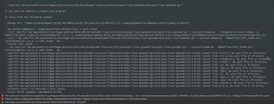

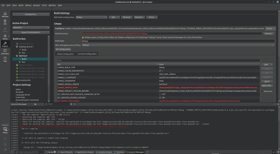

I tried to recompile with imx-image-full as you suggested. Unfortunately it did not make any difference. The screenshot below shows the project -> build&run configuration. At the top there are some red text where it says cmake configuration failed, and further down there is a cmake error also in red, and the line before at the end it says: ".../arm-poky-linux-gnueabi/arm-poky-linux-gnueabi-g++ - broken":

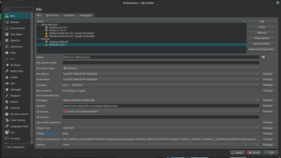

It could be related to the CMake configuration? In the preferences (shown below) I have selected the CMake version (3.29.3) from the toolkit. The reason there is a red dot next to "Run Device" is, that I have had to defined a "remote device" which isn't connected.

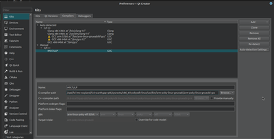

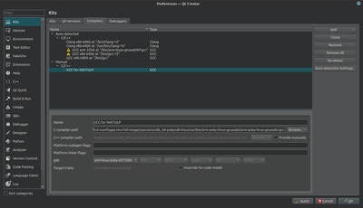

For the compiler settings, I have chosen the compiler in the SDK as shown below:

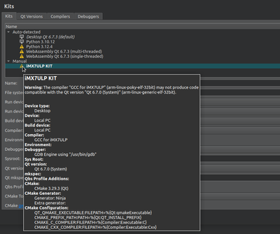

I think a part of the problem is related to the supported Qt version from the Yocto (scarthgap) SDK build, and not the IDE. If I select the latest Qt version 6.8.1 or 6.7.3 I get an error saying (the text is exactly the same if I select 6.8.1 or 6.7.3):
ERROR: The compiler "GCC for IMX7ULP" (arm-linux-poky-elf-32bit) cannot produce code for the Qt version "Qt 6.7.3" (x86-linux-generic-elf-64bit)
There can be several reasons for the error above, one could be a compatibility problem between the compiler provided from the Yocto Bitbake. The other could be that for Qt 6.7.3 and above the text in the parenthesis says that it is 64 bit which doesn't align with 32 bit of the GCC compiler.
To solve the latter, I tried to define the Qt version under "Manage kits..." and select the qmake from the SDK (as shown in the picture).
This replaces the error with an warning:
Warning: The compiler "GCC for iMX7ULP" (arm-linux-poky-elf-32bit) may not produce code compatible with the Qt version "Qt 6.7.0 (System)" (arm-linux-generic-elf-32bit).
Which versions of Qt are supported by the SDK that is "bitbaked" from the Scarthgap imx-linux-scarthgap -m imx-6.6.36-2.1.0.xml?
