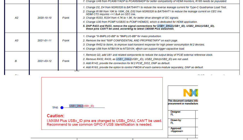

On our custom board with the IMX8MP, we want to configure the USB as OTG without using the PTN5110 IC.
For the ID function, we intend to use GPIO1_10. Below are the code modifications we have made in the DTS.
  1. Are these modifications correct, or do we need to make any further changes to enable USB OTG functionality?
  2. Can we use the OTG_ID pin from the processor instead of using this GPIO? If so, what modifications are necessary to enable OTG functionality?
Your suggestions are appreciated.

I strongly disagree with your statement. Most products do not require a Type-C interface. NXP is pushing its Type-C chips by forcibly incorporating Type-C peripheral circuits into the hardware design. This is particularly unreasonable. To be blunt, this is a poor design. Furthermore, you even tried to impose so-called "suggestions" when answering questions. However, your colleagues did make some compensations.
https://community.nxp.com/t5/i-MX-Processors-Knowledge-Base/i-MX8MM-i-MX8MQ-USB2-0-Design-Without-US...
https://community.nxp.com/t5/i-MX-Processors/USB-OTG-IMX8MPlus/m-p/1692585
Linux already has a binding guide, and other companies have also done hardware designs without Type-C and corresponding device trees.
https://github.com/nxp-imx/linux-imx/blob/lf-6.6.36-2.1.0/Documentation/devicetree/bindings/extcon/e...
https://github.com/nxp-imx/linux-imx/blob/lf-6.6.36-2.1.0/Documentation/devicetree/bindings/usb/usb-...
https://github.com/nxp-imx/linux-imx/blob/lf-6.6.36-2.1.0/arch/arm64/boot/dts/freescale/imx8mp-verdi...
