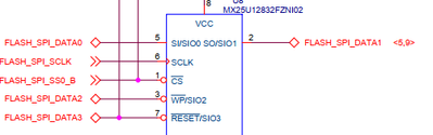

Hi all,
The external flash of my board is MX25U12832FZNI02, how should I configure the SDK(may be need change flash_config.c/flash_config.h files) so that the firmware can be booted from the external flash.
MCU: RT595
External Flash: MX25U12832FZNI02
SDK Example: evkmimxrt595_fbdev_freertos of EVK_MIMXRT595(Note: I can flashing the FW into my board, but there is not any log output)
Looking forward to reply.

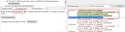

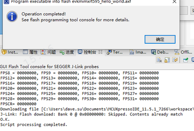

Dave_SU
Hi @jeremyzhou
Step 1~2  completed.
1. Flash FW to my board success. FW cannot bootup, there is nothing of UART output.
2. Online debuging error, which shown as below PIC.
Pls help check it.
3,220 Views
jeremyzhou
Thanks for your reply.
After completing step1 and 2, we can assure the board's hardware connection is good, meanwhile, the QE bit is set and flash_config is good too.
So it should be related flash drivers, I suppose you use the Jlink, the default flash driver is not suitable for your custom board, so please follow the post to update the flash driver.
TIC

jeremyzhou
Hi @Dave_SU ,
First, it needs to verify the QSPI connection is correct, so I'd like to recommend you to use the tool to contact the QSPI, meanwhile, this tool can enable the QE bit of the QSPI.
Second, you should update the flash_config in the flash_config.c to fit for the MX25U12832FZNI02.
Lastly, I needs to know what debugger and IDE you used prior to sharing some advice.
TIC
