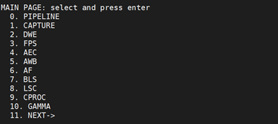

joanxie
if you need to use AEC, AF, you need to use vvext tool, for example
In the Command Prompt window, type:
export LD_LIBRARY_PATH=$pwd:$LD_LIBRARY_PATH
./vvext <video_id>
where <video_id> specifies the video device number in the /dev folder (e.g., video1, video2, …, video 9).
The following menu should appear in the Command Prompt window.

And, btw, vvext /dev/video2 closing silently somehow ( see log below). Any ideas why ?
1|imx8mp-var-dart:/ # dmesg | grep video
[    0.498851] videodev: Linux video capture interface: v2.00
[    1.132965] usbcore: registered new interface driver uvcvideo
[    5.050320] enter viv_video_init_module
[    5.338626] mx8-img-md: Registered mxc_isi.0.capture as /dev/video2
imx8mp-var-dart:/ # vvext /dev/video2
