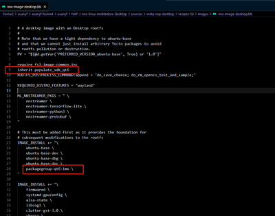

Hi @logic887
Modify below file: https://github.com/nxp-imx/meta-nxp-desktop/blob/lf-6.1.36-2.1.0-mickledore/recipes-fsl/images/imx-i...
Add inherit populate_sdk_qt6 in line 9  and then insert  packagegroup-qt6-imx to IMAGE_INSTALL +=
Best Regards
Zhiming

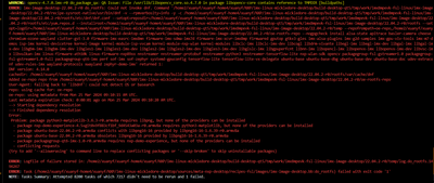

@Zhiming_Liu
How to solve this problem
2,142件の閲覧回数
Zhiming_Liu
Please add nxp-demo-experience in the bb file

logic887
When I use this method, the following error occurs. How should I solve it?
