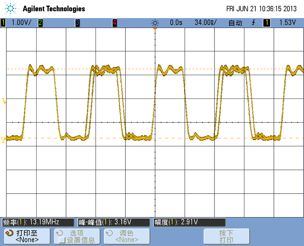

     but i  measured by the oscilloscope:
                                     pclk = 27Mhz,vsync=57.6Hz, hsync=29.3Khz.

this is the pixclock:
HI li,
      Does this problem have progress?
4,914 Views

kaisun1
Log in Accessories. the kernel used default_mode( it is  1920*1080) , but i  measured by the oscilloscope:
        pclk  have not found
4,914 Views
qiang_li-mpu_se
It is not reasonable, since you had already seen the 27MHz Pixel clock with 800*480 setting.
