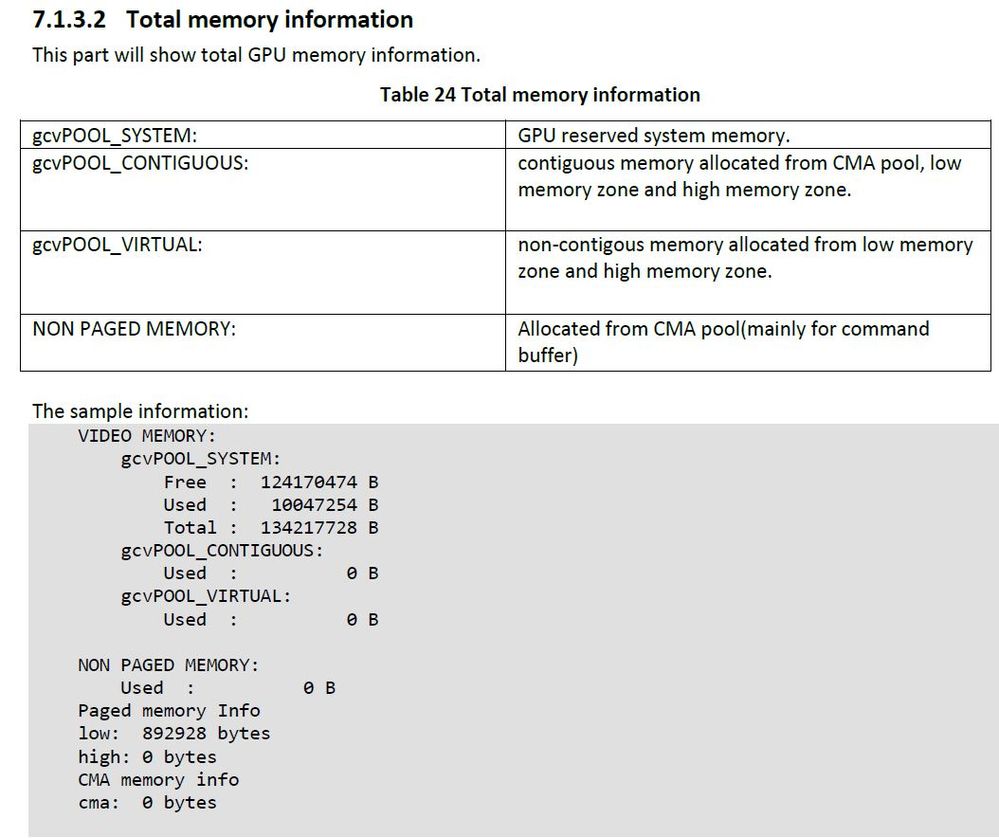

For GPU memory, it would include a few parts, it depends on the specific use case, you can use gpuinfo tools(unit_tests/gpuinfo.sh) to get the memory size data in your own system.

igorpadykov
Hi m.c.
please check considerations on
Memory Management on i.MX6 Android
