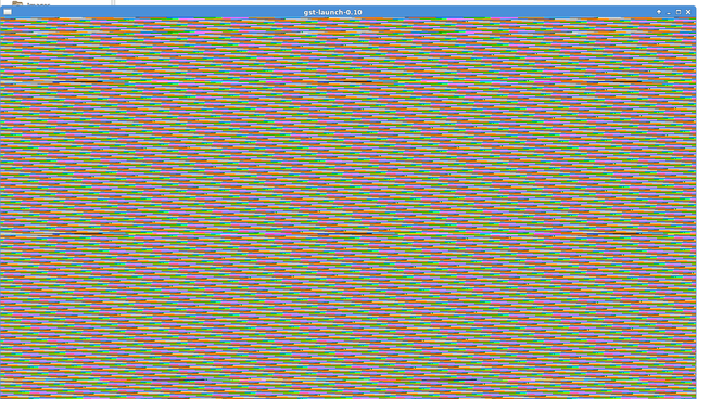

Hi community,
i have a custom camera (999MHz, 4 lane, VC0). I get correct phy_state 3F0 when camera is started.
I check an image (a pattern test image send by my camera) with gstreamer with mfw_v4lsrc module.
But i receive a bad image. In the doc https://community.freescale.com/servlet/JiveServlet/download/328301-262515/Debug%20steps%20for%20cus...
I am in the state C "check the clock setting"
How i can set the HSP_CLK and CCM_PIXEL_CLK clocks ?

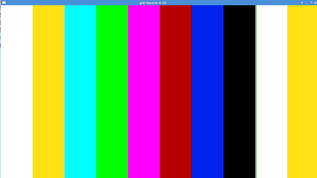

I have tested several configurations of pixel clock with the emi and axi root clock. I receive a bad image : lines seem to shifted. I think there is a bad clock value  for the ipu but i am not certain.
Edit :
I use the boudary linux : ubuntu 3.10.17
the camera send a pattern of 8 color column : white to black.
For configuration pixel_clock 264MHz and ipu_hsp to 396MHz (modification of register in clk-imx6q.c)
if the camera uses mipi lane of 416MHz (=> byte rate 104) the capture work partialy. We have too many 2 columns (white and yellow in the right)
if the camera uses mipi lane of 625MHz (=> byte rate 156) the capture does'nt work

For Q1, MIPI_CSI_PHY_TST_CTRL1 address is 0x021D_C034, you can just reference to the "Debug steps for customer MIPI sensor.pdf" for how to config the mipi clock.
For Q2, ccm_pixel_clock is the camera pixel clock from CSI2IPU to CSI, for iMX6DQ, it is from aclk_eim_clk, in Freescale BSP, we had set it to 198MHz (clk_set_rate(&emi_clk, 198000000);). For iMX6S/DL, the ccm_pixel_clock is from ipu_hsp_clock, it is 270MHz in Freescale BSP..
For Q3, mipi bus clock should be set based on "Debug steps for customer MIPI sensor.pdf" with register CSI2_PHY_TST_CTRL1.
For Q4, Freescale BSP used gated clock mode for ov5640 mipi camera. Note: hsp_clk > ccm_pixel_clk/0.9, this limitation is only for iMX6DQ, when ccm_pixel_clk is from ipu_hsp_clk on iMX6SDL, they are same frequency.
For Q5, you should also check the IDMAC setting, it should use generic mode to receive RAW data.
