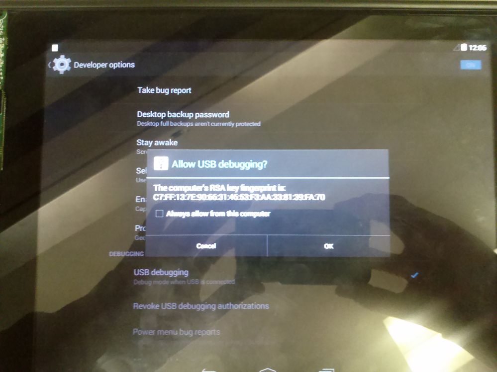

Regarding the target side, have you enabled the "USB debugging" option under "Developer options" of "Settings"? Additionally, when connecting the SABRE to the PC, is there a pop-up message on the Android screen asking if you want to allow debugging from the connected PC? Below you can find a photo of this message, and the status of the ADB device before allowing USB debugging (it is listed as "unauthorized"). After allowing the debugging, it is listed as "device", and I was able to send other ADB commands (like installing apks).

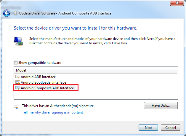

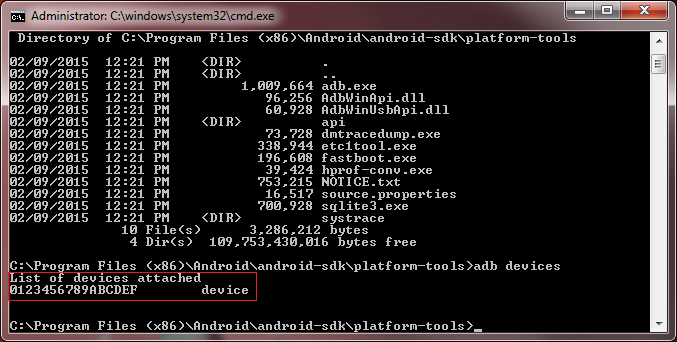

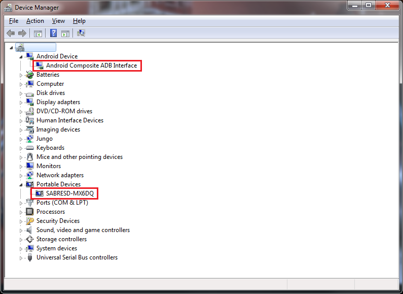

After some investigation, it seems that Windows has some issues with ADB drivers on Android 4.2.2, so, in order to get it working properly (enumerated as "Android Composite ADB Interface") please follow these steps:
1.- On the Windows Device Manager, right click on the "Android ADB Interface" and select "Update Driver Software". Then, select "Browse my computer for driver software". On the next window, select "Let me pick from a list of device drivers on my computer".
2.- On the shown list, it should be included the "Android Composite ADB Interface", so, select it and click on "Next" button. Now Windows should install the ADB device as "Android Composite ADB Interface".

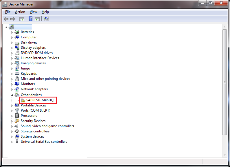

3.- It could be possible that you will get a device with conflicts (SABRESD-MX6DQ) under "Other devices", so it is just required to right click on it and select "Update Driver Software", and then "Search automatically for updated driver software".
4.- After than, you should be able to see the "Android Composite ADB Interface" under "Android Device" menu, and also the "SABRESD-MX6DQ" under "Portable Devices" menu, and it should be listed by calling the "adb devices" command on the prompt window.
Below you can find some screen captures of the relevant parts of this procedure:

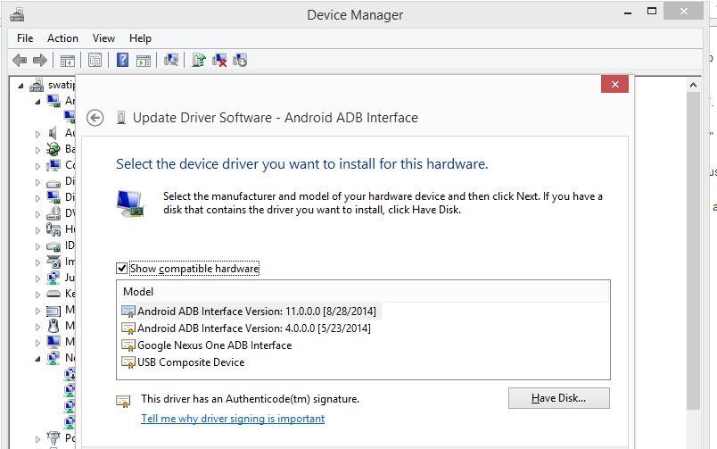

   Thanks for trying out 4.2.2 with windows 8.1. But unfortunately I don't see "ADB composite interface" listed in the device manager. when I follow above steps.
   Picture attached. I tried to search complete hardware list as well (unclick show compatible hardware, it shows complete list) . No luck
   If the problem is specific to 4.2.2, Is there a way to get 4.4.2 demo image and flash it?
