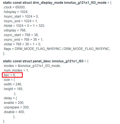

mallibeerala
Hi Zhiming,
I am using below timings.
static const struct drm_display_mode innolux_g121x1_l03_mode = {
.clock = 65000,
.hdisplay = 1024,
.hsync_start = 1024 + 0,
.hsync_end = 1024 + 1,
.htotal = 1024 + 0 + 1 + 320,
.vdisplay = 768,
.vsync_start = 768 + 38,
.vsync_end = 768 + 38 + 1,
.vtotal = 768 + 38 + 1 + 0,
.flags = DRM_MODE_FLAG_NHSYNC | DRM_MODE_FLAG_NVSYNC,
static const struct panel_desc innolux_g121x1_l03 = {
.modes = &innolux_g121x1_l03_mode,
.num_modes = 1,
.bpc = 6,
.size = {
.width = 246,
.height = 185,
.delay = {
.enable = 200,
.unprepare = 200,
.disable = 400,
Mallikarjuna

Zhiming_Liu
You set bpc=6 in timing, you can try bpc=8
