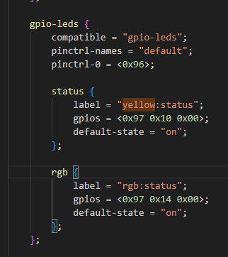

I am trying to control pin 40 of J21 header in the board. I went through schematics and reference manual and found its connection to GPIO3_20 pin in the processor. So, I proceeded to add following entries to the gpio-leds section in device tree:
        rgb {
            label = "rgb:status";
            gpios = <0x97 0x14 0x00>;
            default-state = "on";
 My dts file looks like this:
Why gpios = <0x97 0x14 0x00> ?
0x97 is the phandle to gpio controller I am trying to access. GPIO3 is located in 30220000 as per the reference manual.
0x14 (hex) = 20 (dec).
0x00 = Active high.
I compiled  this dts file to dtb, uploaded it into boot partition and booted the device. I can see the entry /sys/class/leds/rgb:status . At this moment, the voltage at pin 40 reads 0.2V. Even after echo 1 > brightness or echo 0 > brightness, the voltage level at pin 40 does not seem to change.
What am I doing wrong exactly? I am really confused at this point and any guide would be of great help.

Hi @bgaurav1718!
Thank you for contacting NXP Support!
To add the pin 40 as a GPIO you should declare as the next:
gpio-leds {
		compatible = "gpio-leds";
		pinctrl-names = "default";
		pinctrl-0 = <&pinctrl_gpio_led>;
		status {
			label = "yellow:status";
			gpios = <&gpio3 16 GPIO_ACTIVE_HIGH>;
                rgb {
                        gpios =  <&gpio3 20 GPIO_ACTIVE_HIGH>;
and under pinctrl_gpio_led node you have to add the proper configuration for the pin.
	pinctrl_gpio_led: gpioledgrp {
		fsl,pins = <
			MX8MP_IOMUXC_NAND_READY_B__GPIO3_IO16	0x140
                        MX8MP_IOMUXC_SAI5_RXC__GPIO3_IO20       0x140
Best Regards!

bgaurav1718
Thank you @Chavira  for your response.
I made changes as you recommended and the dtc compiler throws errors.
    Error: syntax error
    FATAL ERROR: Unable to parse input tree
    Error: syntax error
With regard to pin configuration,  I didn't find the node pinctrl_gpio_led.
It is defined as
pinctrl_gpio_led = "/soc@0/bus@30000000/pinctrl@30330000/gpioledgrp";
inside __symbols__ {}
However, I can find the gpioledgrp node, so I guessed this to be the node you were referring to in order to add pin configuration. In original dts file, it is defined as
                gpioledgrp {
                    fsl,pins = <0x120 0x380 0x00 0x05 0x00 0x140>;
                    phandle = <0x96>;
I added the pin configuration and now looks like this:
                gpioledgrp {
                    fsl,pins = <MX8MP_IOMUXC_NAND_READY_B__GPIO3_IO16 0x140                                                          MX8MP_IOMUXC_SAI5_RXC__GPIO3_IO20 0x140>;
                    phandle = <0x96>;
Error: syntax error
I have added the dts file, which is decompiled from original dtb file (Command: dtc -I dtb -O dts -f imx8mp-evk.dtb -o imx8mp-evk.dts), in my original post.
I suspect something to be wrong with my dts file. I am not sure though.

bgaurav1718
Thank you @Chavira for the patch.
I figured out the values for erroneous macros from kernel source and I got the control in user space for the specified pin.
Adding the pin configuration details in pinctrl_gpio_led node did the trick.
However,  when I remove sub-nodes from inside gpio-leds node,  I can turn on/off the yellow:status led from libgpiod cli tool. But, doing same doesn't make any difference in case of header pin 40. I still have configuration details in pinctrl_gpio_led node.  Any suggestion where I need to look for errors?

Chavira
Hi @bgaurav1718!
Sorry for my mistake!
Cheking detailed the problem was that pin is used in the node micfil.
To use as a gpio the pin 40 you have to disable the micfil functions in the line 860.
https://github.com/nxp-imx/linux-imx/blob/lf-6.1.y/arch/arm64/boot/dts/freescale/imx8mp-evk.dts#L860
change the line:
status = "okay";
to :
status = "disabled";
and then you should able to use the gpio pin.
Best Regards!
Chavira
2,865件の閲覧回数
bgaurav1718
This works perfectly. Once again thank you so much @Chavira
