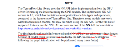

I just find some information about the accelerate of tensor flow lite model , maybe you can test it the second time.
The first iteration of model inference using the NN API always takes many times longer,
because of model graph initialization needed by the GPU module. The iterations
following the graph initialization will be performed many times faster.

The attached file explain how it works.
