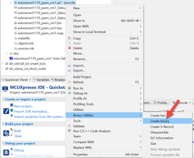

1) According to your statement, you want to know the steps of generating the HEX file with a specific offset from the flash start address, if my understanding is right, you can follow the below steps to do it.
1) Modify the memory map;
2) Then build the demo again to generate the AXF file;
3) Last, generate the HEX file just as the figure shows.
