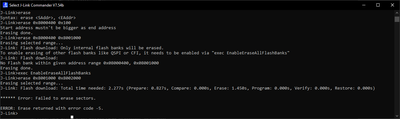

skanda19
Hello @kerryzhou,
I been trying to do the same with the rt600 on a custom evk runnning on flexspi port A Octal.
By following your note on the rt1170, I was able to get to the point where in the IDE seems to do a successful operation when I flash it with the RT UFL algo. But is not actually flashing.
Also, I get this error when I try to erase memory with j-commander :
To what I believe is that RT algorithm needs to support octal and I need to enable it. Can you give some detail on how to do this with the rt600 ?
Thanks!
