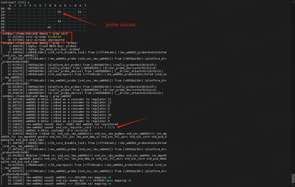

I am debugging the wm8962 audio chip on the i.mx 6ull, and now I don't know why there is no sound from either the headphones or the speaker. By observing the log, it seems that there is a problem with the configuration of sai2. However, I have connected these pins of sai2 to the wm8960 audio chip and confirmed that there is no problem. Now I need to check whether there is a problem with my device tree configuration or the hardware device?

The log:
loglog

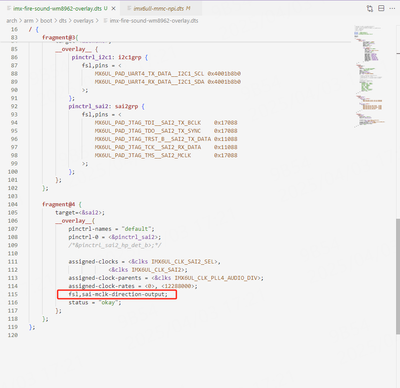

I suggest you use our device tree as reference:
linux-imx/arch/arm/boot/dts/nxp/imx/imx6ull-9x9-evk.dts at 37d02f4dcbbe6677dc9f5fc17f386c05d6a7bd7a ...
I see that you are not using mclk property to use it as output in SAI2 node, please check if this helps with your design.
I do not see issues in hardware connections.

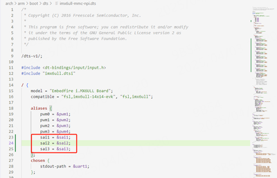

Your suggestion played a substantial role in my registration failure error, and also reminded me of the alias problem. The above error no longer appears, but now there is a problem with playing music. I think it is probably a problem with my hardware. I will check the WM8962 module problem myself. Thank you for your help.
The following figure shows the changes I made to the main device tree and the device tree overlay. I hope it can be used as a reference when others encounter this problem in the future.main device treemain device tree
device tree overlaydevice tree overlay
