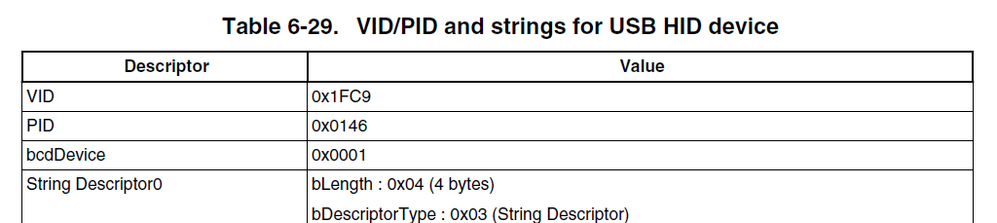

matato
i.MX 8M Plus Applications Processor Reference Manual, Rev. 1, 06/2021
6.1.7 USB boot

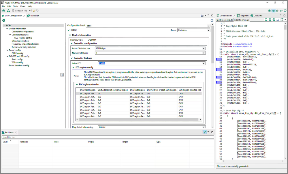

Cyriactoms
Download is complete
Waiting for the target board boot...
H�������������������B���݅ɕ}�����====================
********Found PMIC PCA9450**********
hardware_init exit
MX8 DDR Stress Test V3.30
Built on Nov 24 2021 13:52:12
Waiting for board configuration from PC-end...
--Set up the MMU and enable I and D cache--
- Check if I cache is enabled
- Enabling I cache since it was disabled
- Push base address of TTB to TTB
- Config MAIR_EL3
- Enable MMU
- Data Cache has been enabled
- Check system memory register, only for debug
- VMCR Check:
- ttbr0_el3: 0x97d000
- tcr_el3: 0x2051c
- mair_el3: 0x774400
- sctlr_el3: 0xc01815
- id_aa64mmfr0_el1: 0x1122
- MMU and cache setup complete
ARM clock(CA53) rate: 1800MHz
DDR Clock: 0MHz
DDR configuration
DDR type is LPDDR4
Data width: 32, bank num: 8
Row size: 17, col size: 10
Two chip selects are used
Number of DDR controllers used on the SoC: 1
Density per chip select: 4096MB
Density per controller is: 8192MB
Total density detected on the board is: 8192MB
Please re-download with the correct value
When i run the ddrc test  its showing like this and not able to calibrate
12,368 Views
Cyriactoms
DDR configuration DDR type is LPDDR4 Data width: 32, bank num: 8 Row size: 17, col size: 10 One chip select is used Number of DDR controllers used on the SoC: 1 Density per chip select: 4096MB Density per controller is: 4096MB Total density detected on the board is: 4096MB ============================================ MX8M-plus: Cortex-A53 is found ************************************************************************* ============ Step 1: DDRPHY Training... ============ ---DDR 1D-Training @1600Mhz...
during calibration it is not progressing
12,358 Views

Harvey021
I think that your board is i.MX8MP. Please refer to the i-MX-8M-Family-DDR-Tool-Release
Harvey
12,001 Views
Cyriactoms
i have downloaded the exact version for imx8mp
then getting this output
12,247 Views
