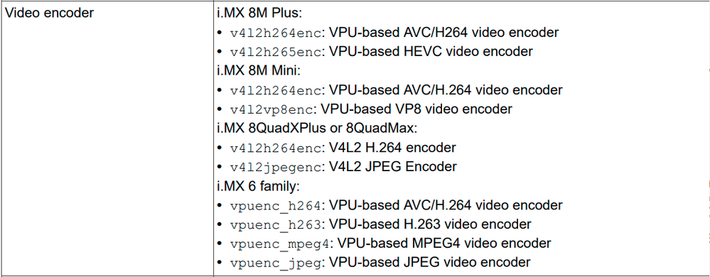

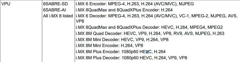

i.MX8 & i.MX6 series does have VPU for H.264 encoding.
GStreamer 1.0 plugins for the same are also available.
