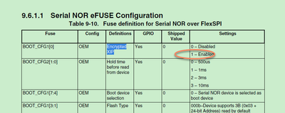

  The BEE need to burn the fuse, and BOOT_CFG1[0], Encrypted XIP should be enabled:
Otherwise, the BEE boot will be failed.
