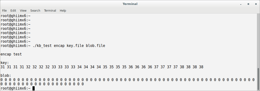

I implemented the Generate blob under linux v2 as detailed here:
https://community.nxp.com/docs/DOC-335353
My device is an imx6s.  The test app runs but the blob file is always zero.  My device is closed, no errors are reported, and I can generate a blob in u-boot.  What could be wrong?

  I think it makes sense to apply directly to author of the original document, published
on https://community.nxp.com/docs/DOC-335353
Yuri.
